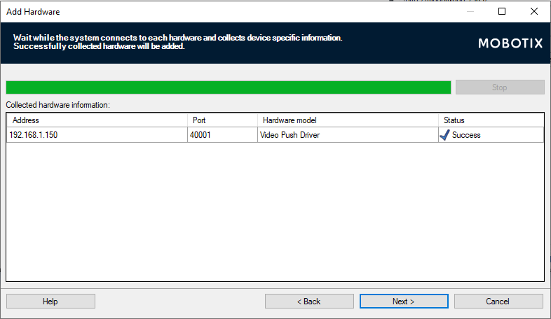

Hardware will be right detected
Click Next
Hardware information will be collected successfully
Click Next

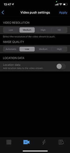

Click on Start to activate the connection to the Mobile Server and Recording Server
By clicking on Settings you can configure the Video Resolution and Image Quality
