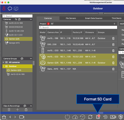

How to format an SD Card using the camera
Simple and Easy - Format the SD Card with the MxMC
The best way to format the SD Card of a camera or multiple cameras is possible via the MOBOTIX Management Center (MxMC) by using the Component View and select the camera where you want to format the SD card and press the SD Card Symbol.
More infos of the MxMC SD Card Format check out the follow report:
