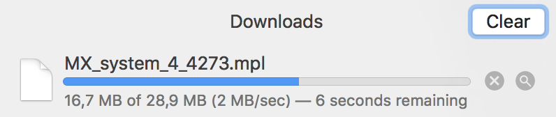

Step 6. Proceed to Download the MPL or ZIP version of the firmware. The MPL file will be accepted by the camera , the ZIP version must be extracted as it contains the MPL file.
Step 7. Input your details , Agree to the data protection notice and the terms of use for MOBOTIX Software and click on Submit.
The download will start
