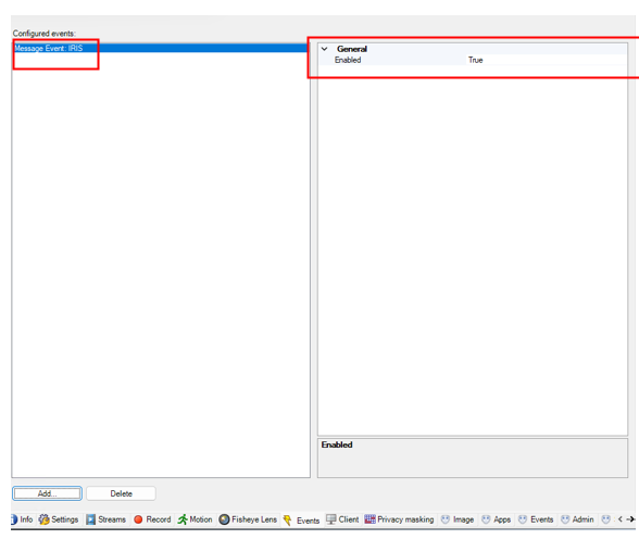

Configuring the Irisity Intrusion App in HUB (Forensic Search)
1.- Add your camera to the MOBOTIX HUB Recording Server.
2.- In the MOBOTIX HUB Management Server, click on your IRISITY camera.
3.- Click “Events”
4.- Click “Add” and select “Message Event: IRIS”
5.- Click “Ok”
6.- If the event is listed, you will see it under the Configured Events section. You can enable or disable it by changing the value to “True” or “False”.

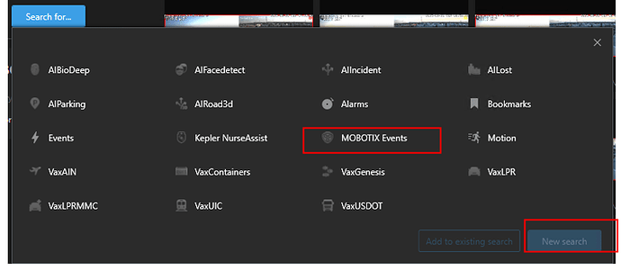

Check the Forensic Search results in the MOBOTIX HUB Desk Client
1.- Open Mobotix Desk Client.
2.- At the top, click the “Search” button.
3.- Select the correct camera
4.- Click the “MOBOTIX Events” button and then select “New Search”
5.- Select “Message Event” option.

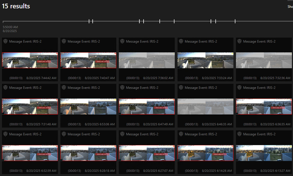

6.- All events within the selected time range will automatically be displayed.
