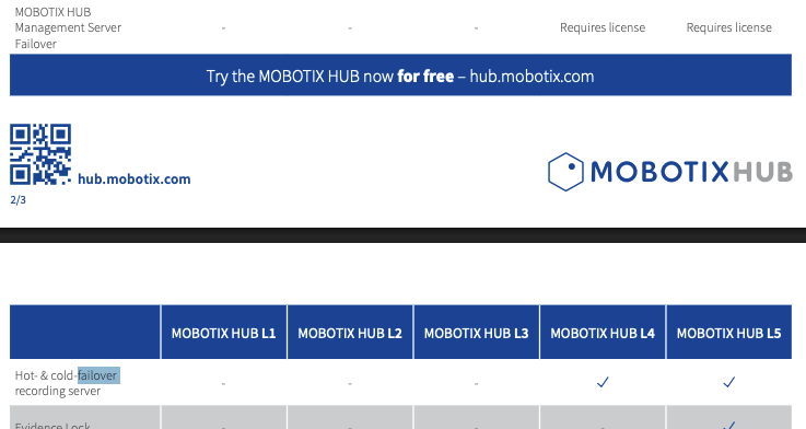

Failover for Recording Server - Hot & Cold Failover is only included in the Hub Version L4 & L5 https://www.mobotix.com/sites/default/files/2024-06/mx_Flyer_MOBOTIX_HUB_Funktionen_en_240606.pdf
Failover for the Management Server require a separat License:
License: Mx-HUB-MgmtSrvFailover
Note: You do not need separate device licenses for the cameras when using MOBOTIX HUB Management Server Failover .
