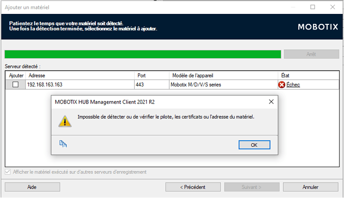

I would like to know how to add a mobotix D71 in the MxHUB with MxPeg codec. I can add the camera with ONVIF profil, but I need to do it with mobotix driver to use the IA of the camera.
Mx HUB: 2022 R1
Firmware D71 : MX-V7.3.1.31-r3
Device pack: 12.1
Thank you,
Have a nice day,
Jérôme
