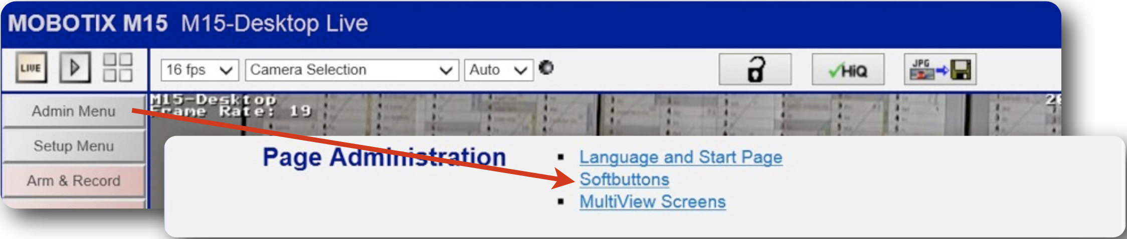

Go to Amin Menu >> Softbuttons.
Scroll down the page and type the following information into the last empty line then press “Set” to apply the settings:
