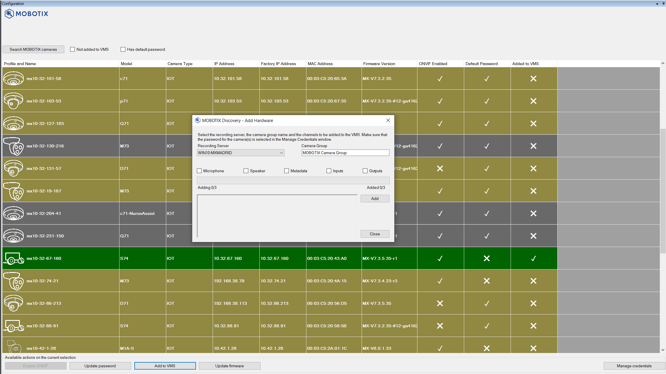

Colour legend:
Grey == Camera not selected
Yellow == Camera is selected
Green == Camera is already added to the MOBOTIX HUB VMS

The MOBOTIX Operator Discovery offers the following functions at a glance
Discovery:
  • Find MOBOTIX MOVE cameras in the same subnet
  • Find MOBOTIX IOT cameras in all subnets of the same physical network (regardless of the cameras’ network settings)

**Simply add cameras

Open camera in browser
Right-click on a camera in the list to open a browser window with the selected camera. Helpful for specific camera settings before adding them to the MOBOTIX HUB VMS.
Multiselection: If several cameras are selected, a browser window opens for each camera!
