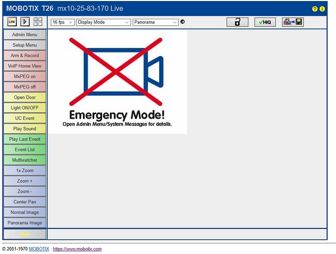

anyone experiencing about the T26 camera didn’t display in browser, I have 3 unit of T26 with the same problem when I open the box and plug it to Poe switch and access through web browser, it’s required me to change the password and after that I didn’t see the camera,
I have 6 unit in total with the same model, but the 3 is working properly and the 3 is not,
Any idea about my case?

I don’t have problem about the IP and other settings of mobotix T26, the problem I encountered is only the camera no video display, but the Sip Server and client is working.
Please see attach.

Hello @mmosende ,
the Emergency Mode is avaiable when the internal RTC Battery is a little bit discharged.
So please do the following steps:
- The T26 should be connected via PoE at least for min. 3-6h.
- Set the date&time to the current dates -> Save the settings permanently
- Disconnect the PoE Connection to the T26 and restart it
Then you should be able to see the Liveimage and you can start an Autoconfiguration.
