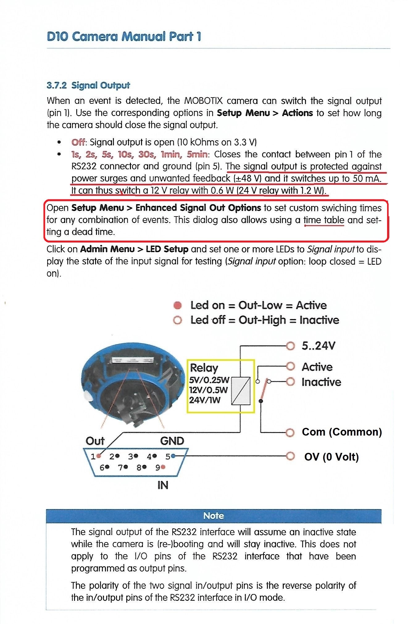

Seeking help to identify economical “Relay” purchase option for use with MX D10D-FixDome “RS 232 Signal Out (SO)” control of outside LED strip lighting. MX D10D-FixDome purchased in 2006 and still functioning “perfectly”!) LED strip lighting operation through “Time Table” - - setting: “On” Daily 22:00 - 22:59; “Off” 23:01. Components, 1) MXD10, 2) Relay, and 3) LED strip lighting and to operate w/own power source.
Thank you very much for Relay purchase suggestion, and any advice regarding this set-up may or may not work. … rgds MLL

Thank you for your thoughts on this. LED strip lighting will be 110-120VAC, so lighting will need own power source (110 electrical outlet). Also, MXD10 “RS 232 Signal Out (SO)” connector is only option, as 2006 built MXD10 has only three (3) connectors… i. 10BaseT (Ethernet network), ii. In/Out - RS232, and iii. ISDN. Therefore, will need 12V RIB (Relay In A Box - waterproof) with RS 232 interface, and
own power source. … rgds MLL
Thank you for your reply. Continue to investigate RS-232 serial Relay to turn on/off
lighting. Answer may be inside this Mobotix doc… http://www.tejashummer.com/SignalOutputRS232Interface-Relaya-German%20Dia_9-10-20.pdf in German language. Possibly someone can translate for me and send English pdf doc.translation by email (hm@tejashummer.com. Warm regards. … MLL
