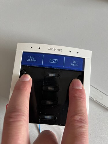

Second Mechanical check is to remove the Buttons of the BellRfiD itself to see if the random Calls stopp´s.
Screenshot 2025-10-29 at 10.10.46
Please check the black small buttons afterwards , if the “klick” behaviour on all identical or if one of them not “klick”

When I had removed the bellbuttons yesterday I already had a look at these arrows, however the arrows were hard to distinguish. I have now inserted them the other way around just for testing. Apparently it does not make any difference. It is strange that this has worked for so many years without a problem. It is also not clear to me how the direction makes any difference, the buttons look quite symmetrical.

I removed the key, but the problem still occurs.
I noticed something strange on the middle lower button of the module:
Also, when i push the middle buttons of the upper key, the door bell (through my media server with an http request) rings and also the doorstation bell. However, when I push the middle buttons of the lower key, the doorbell does not ring even though that is the one that generates the random door bell rings…The doorstation bell does not ring, I only hear a beep and the blue LED in the right hand corner lights up.
Thanks.

After you removed the button inlays and the random ringing still occurs, while the BellRFID works properly on the second button, I assume you’ve already checked that the side buttons produce a normal “click” sound. Based on that, I would exclude the following issues:
  • A mechanical issue caused by a stuck inlay button
  • An MxBus connection issue, since the other button functions correctly and only signals when pressed
We see very few defective BellRFID units in our repair department. While a hardware fault is possible, I find it unlikely in this case.

  • The system integrator that installed the T25 did not provide the keyboard inset, required for the setup, nor the RFID cards.
    Also, I have no idea what the SuperPIN is. Is this reset to the factory default as well? In the video the person enters 123456789. Is this the factory default?
I have contacted the system integrator but have not received any news yet. In the mean time they have switched to a different brand of doorstations many years ago, so I doubt they will be of any help…
At this moment I have disabled the RFID module (not physically, but in the Admin setup pages, otherwise I can’t open the door anymore with the fingerprint reader that is part of the system…
Since then we have had no ghost key presses…
