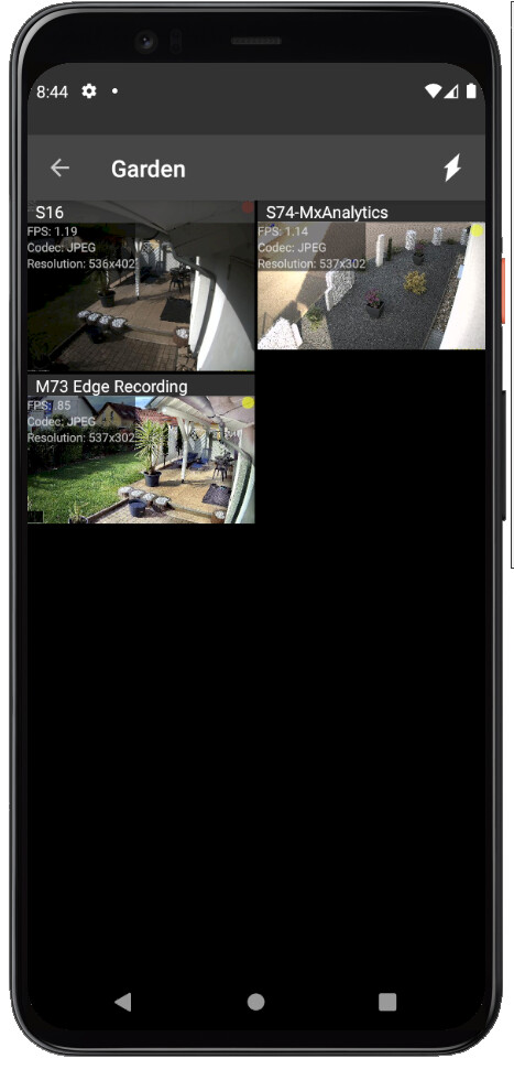

7. Open the HUB Mobile App
Login with the User which have the permission to see the view group.
How to add the MOBOTIX HUB into the App can be seen in this article:
After the App starts you will have an overview of your created views.
by clicking on the first view, you will get only the cameras of this view.
by clicking on the second view, you will get only the cameras of this view.
