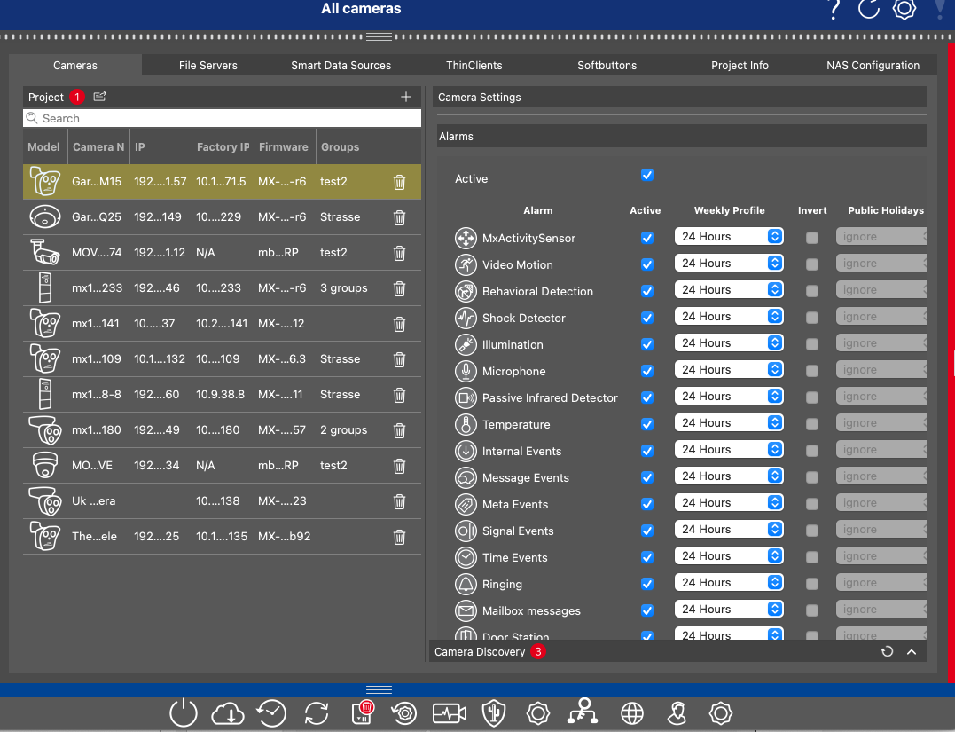

i assume you would like to get based on an Camera Event a Alarm Notification in the MxMC.
This must be enabled in the MxMC Preferences:
In the setting of each camera the Alarm must be activated and the Event which should trigger an alarm must be selected (By default this is activated)
Plus the Cameras must have valid configured Events which trigger the MxMC Alarm.
This description above are relevant for all Cameras Models from X4,X5,X7 and ONE.
IF some of the cameras are not show a alarm window may the public access in the camera is enabled. The Public access must be disabled in all cameras!.

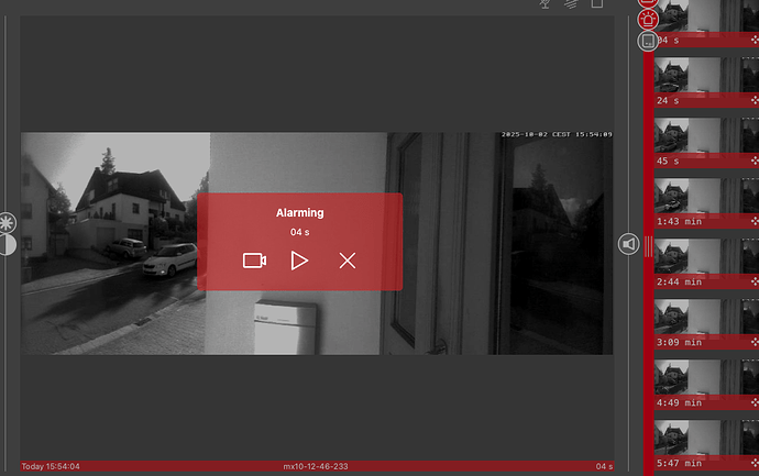

For the M12 Camera the notification is working via a IpNotify and trigger a MxMC Remote Command to pop up a alarm window.
