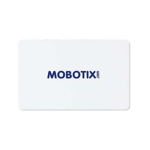

About RFID Cards:
We no longer have RFID cards in stock, but you can obtain them from partners:
Alternatively, you can use any RFID card that complies with the following standard: MIFARE DESFire EV1 4K RFID
